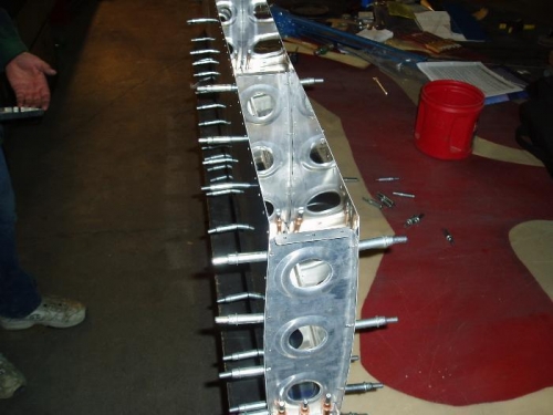

Brief Description:  Cleco horizontal together
Fluted all horizontal ribs, drilled out horizontal spars and ribs, and clecoed left hand horizontal together.
Some of the HS-904 ribs didn't line up with the holes in the skin, so we took a piece of aluminum and clamped it and the rib into the vice, then we bent down the flange that connects to the front spar with a rubber malet to shorten the rib slightly.
as you can see 100 #30 clecos isn't enough.
