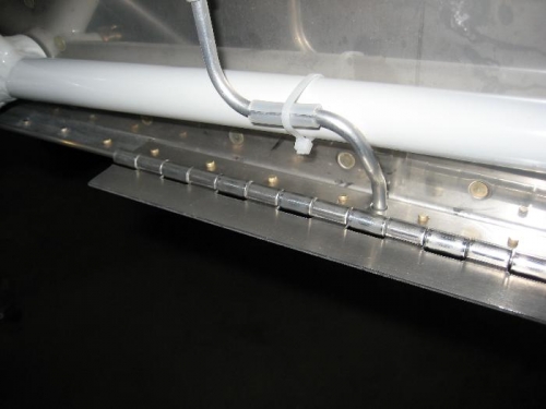

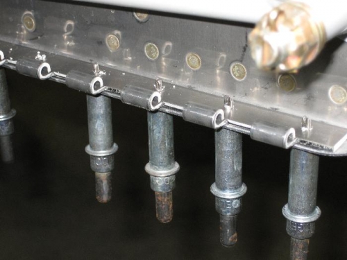

Located carb control fitting bearing ends and installed fittings. Not ready to install control cables until switch subpanel is completed. Cut, matchdrilled, deburred and riveted bottom cowl hinge halves to fuselage.
