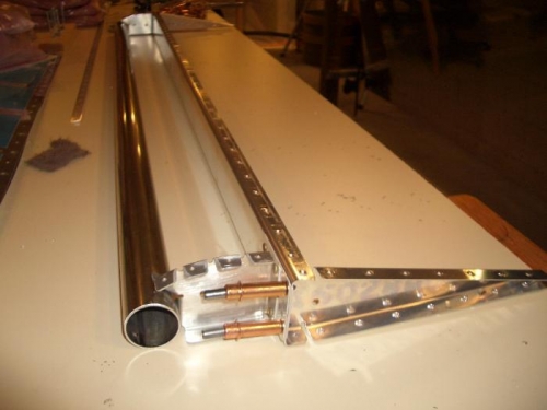

Brief Description:  Continued Ailerons
Back-riveted skin stiffeners to skins. Assembled main ribs to aileron spars. Match-drilled skins to ribs and spars. Assembled nose skins to ailerons and match-drilled. Disassembled right aileron, deburred, and dimpled/countersunk all parts. Started final assembly of left aileron by riveting counterweight to nose ribs to spar.
