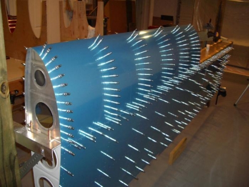

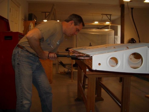

Brief Description:  Leading Edge And Fuel Tank
Constructed leading edge cradle from shipping crate wood. Deburred and fluted nose ribs. Assembled nose ribs into leading edge. Mounted and clecoed leading edge on left wing. Installed doubler strip between leading edge and tank. Matchdrilled all leading edge holes.Deburred and fluted left tank ribs. Assembled tank ribs into tank skin.
