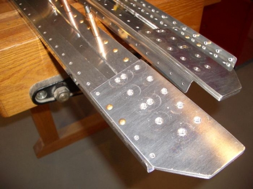

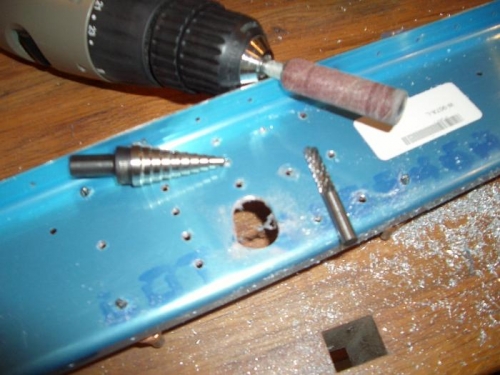

Match-drilled reinforcement plates to rear spar. Deburred holes and riveted plates to spar. Countersunk holes for flush rivets.Deburred and fluted main wing ribs. Clecoed ribs to main and rear spar.
Aileron Push Rod Hole
Rear Spar Reinforcement Plates
