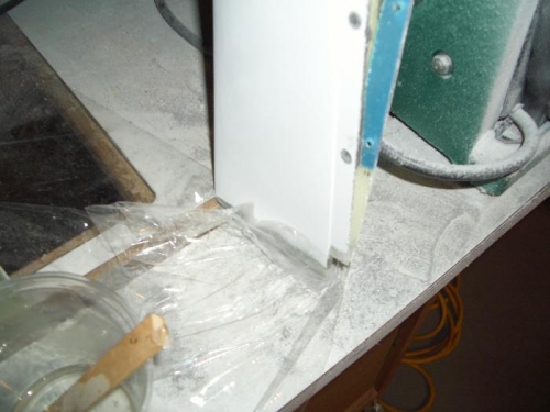

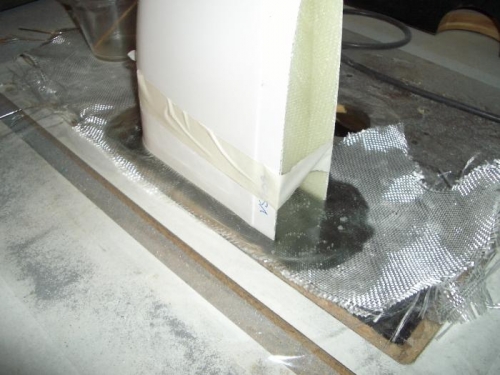

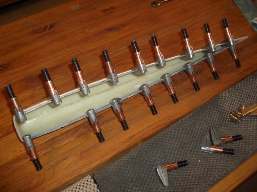

Fitted and trimmed VS fiberglass tip. Fiberglassed end of tip closed, let cure, then applied two more layers of mat to the inside.Matchdrilled rudder fiberglass tip to rudder, countersunk tip and dimpled rudder. Bonded rivet backing plates to rudder fiberglass tip.
Vertical Stabilizer Tip
Reinforcing Elevator Tip End
Rivet Backplates on Rudder Tip
