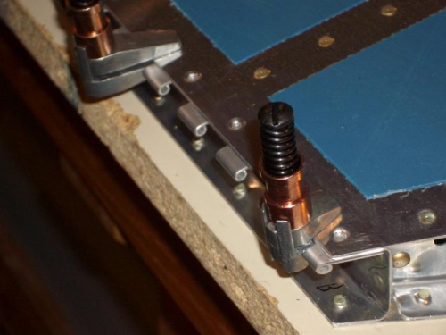

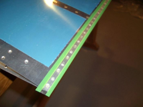

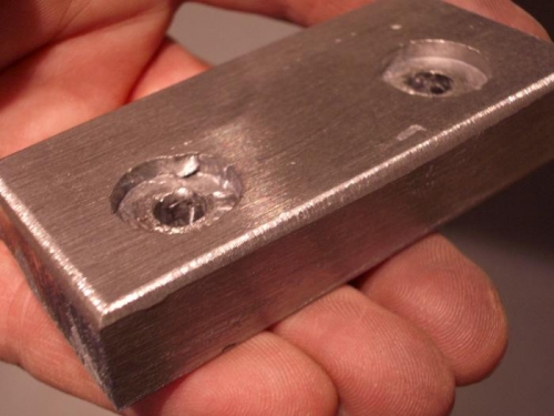

Removed clecoes from left elevator trailing edge and cleaned ProSeal from holes. Placed rivets and rivet tape in preparation for riveting.Attached elevator trim tab hinge half to left elevator in preparation for riveting.Trimmed and sanded right elevator counterweights. Sanding them on the belt sander makes them look very nice, and it doesn't clog up the sanding belt.
