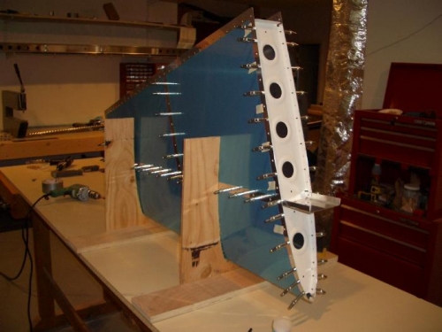

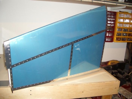

Assembled VS rear spar riveting spar doubler and hinge plates to spar. Riveted ribs to front spar and assembled to skin using horizontal stabilizer blocks. Riveted skin to VS skeleton. Left rear spar off pending inspection by Tech Counselor.
VS in HS Blocks
Completed Vertical Stabilizer
