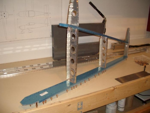

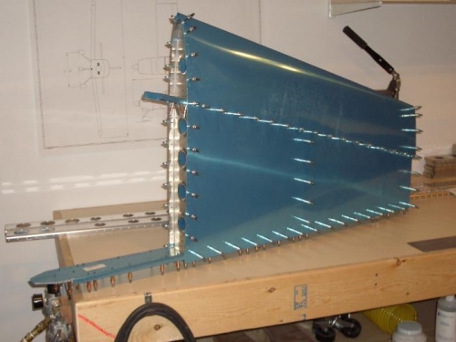

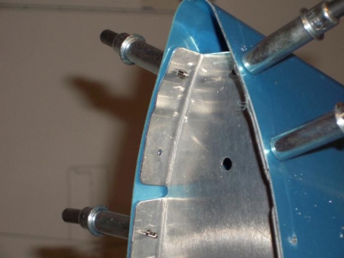

Straightened VS spars and spar doubler. Fluted VS ribs. Clecoed skeleton and match-drilled. The forewardmost holes on the two nose ribs were not prepunched, so I used the holes in the skin to drill through the ribs. Clecoed skin to VS and matchdrilled.
Vertical Stabilizer Skeleton
Missing forwardmost Holes Drilled
Clecoed Vertical Stabilizer
