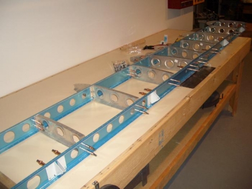

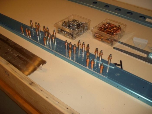

Assembled front spar doubler to front spar. Assembled rear spar doubler to rear spar. Fabricated two attach angles and assembled to front spar. Fluted and deburred nose and main ribs and assembled to front and rear spar. Disassembled everything and marked for reassembly.
First step - Assembled front spar

Assembled stabilizer skeleton
