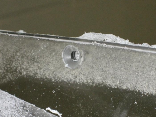

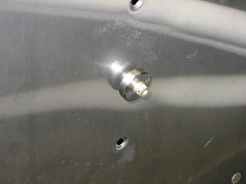

Dimpled holes on top of firewall using screws and rivet dimple die set. I didn't have a rivet puller large enough for the 1/8" holes. Finished countersinking and deburring canopy and rear window.
Using Screw to Dimple
Countersunk Rear Window
