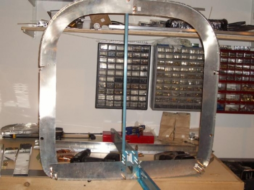

Brief Description:  Bulkhead Assemblies
Fabricated and mounted the center section bar, bar doublers, and spacers to the rear spar attach bulkhead. Drilled the seat belt anchors and trimmed as necessary. Fabricated and drilled the angles, plates, and seat adjustment angles to the bulkhead channel. Disassembled and deburred the bulkhead components.
