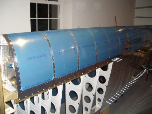

Brief Description:  Finished Right Fuel Tank

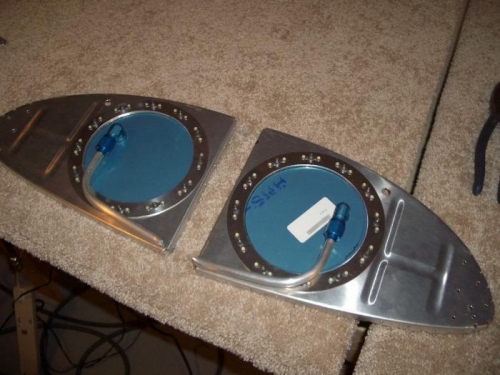

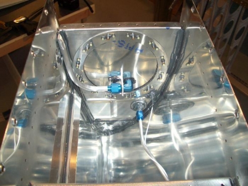

Fabricated fuel pick up tubes and antirotation brackets and installed on inboard ribs. Installed tank vent bulkhead fittings. Trial-fitted inboard ribs to measure for capacitive fuel level wiring. Cut and terminated wiring. Installed inboard ribs and made final connections on both tanks. Installed rear baffle on right tank and riveted. Installed right tank support brackets and riveted. Mounted right tank on wing.
Fuel Pick Up Tubes
Fuel Pick Up Tubes
Completed Inboard Rib
