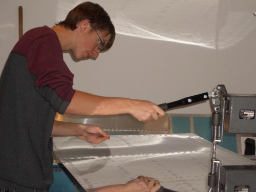

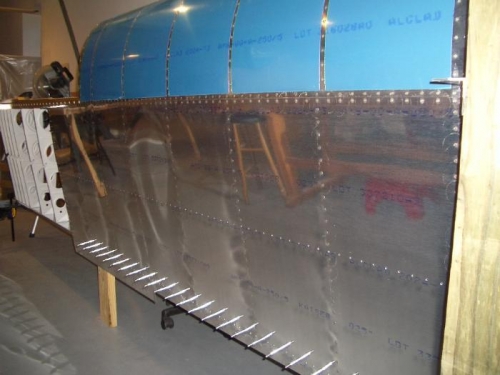

Assembled left leading edge in the cradle with clecoes. Riveted ribs to leading edge skin.Deburred and dimpled right top outboard wing skin. Clecoed skin to wing skeleton. Riveted skin to ribs using extended backriveting set and backriveting bucking bar.
Son Dimpling Top Skin
Top Skin Riveted
Top Skin Riveted
