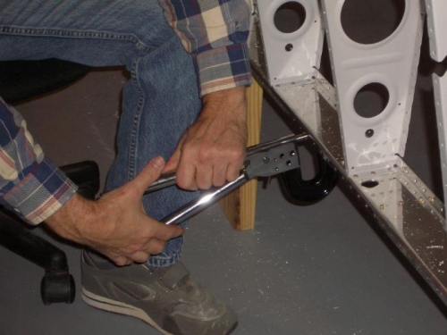

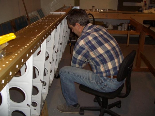

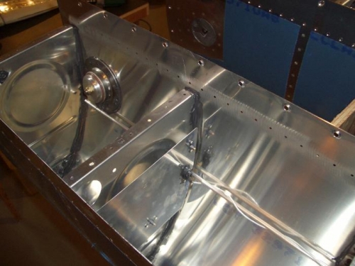

Brief Description:  Installed Capacitive Fuel Probes
Installed outboard capacitive fuel probe plates onto ribs. Ran wires toward inboard plates. Installed vent lines through grommets and clip under fuel filler.Deburred and dimpled all holes on right wing ribs and rear spar. Countersunk holes on main spar.
Outboard Capacitive Fuel Probe Plate
Dimpling Rear Spar
Dimpling Rear Spar
