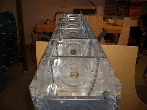

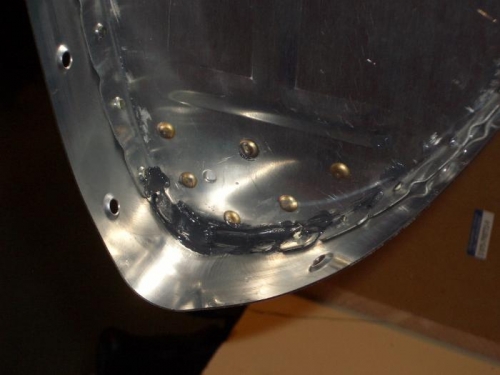

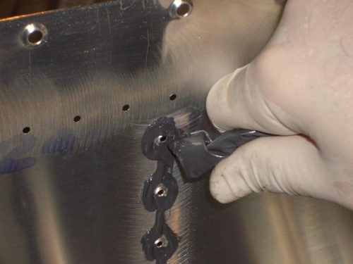

ProSealed Tank Ribs
Assembled left and right tanks with clecoes. ProSealed and riveted each rib into the tanks one at a time. Completed all but the inboard ribs. Waiting on replacement parts from Vans.
