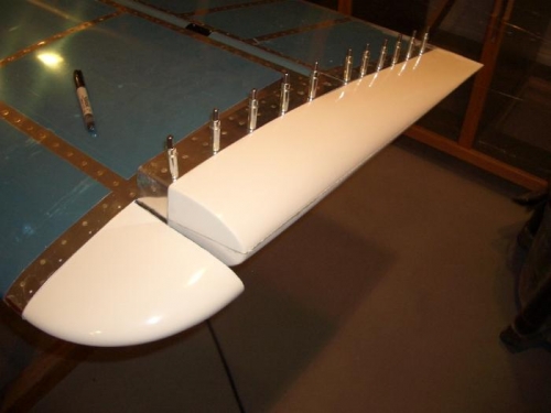

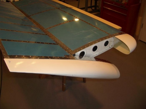

Finished riveting rear spar to horizontal stabilizer skin. Finish drilled center hinge holes in elevators and reattached to horizontal stabilizer. Trimmed and fitted fiberglass tips to elevators and stabilizer. Drilled left tip and clecoed to elevator.

Elevator Tips
Elevator Tips
Elevator Tips Clecoed
