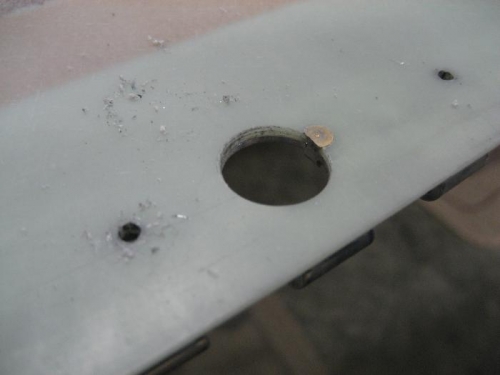

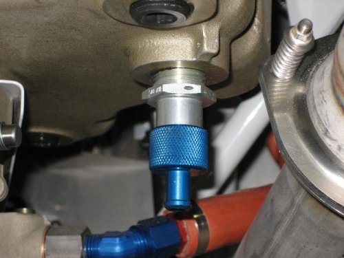

Assembled gascolator drain extension to reach through lower cowl, using 2" nipple, coupler, and drain valve. Finished riveting hinge halves to lower cowl. Cut hole in lower cowl for gascolator drain. Installed and safety wired oil quickdrain on engine.

Gascolator Drain Hole In Cowl
Oil Quick Drain
Oil Quick Drain
