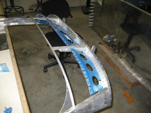

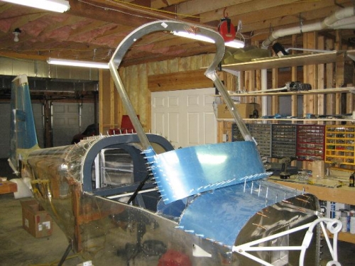

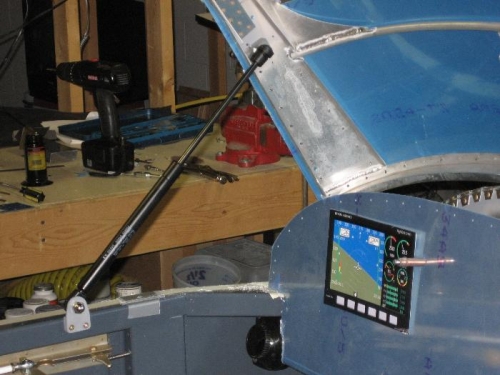

Tapped holes in canopy frame lift brackets and installed brackets. Installed struts. Removed & disassembled canopy frame and deburred and countersunk all holes. Fitted canopy frame brace kit and matchdrilled to forward canopy skin and frame.
