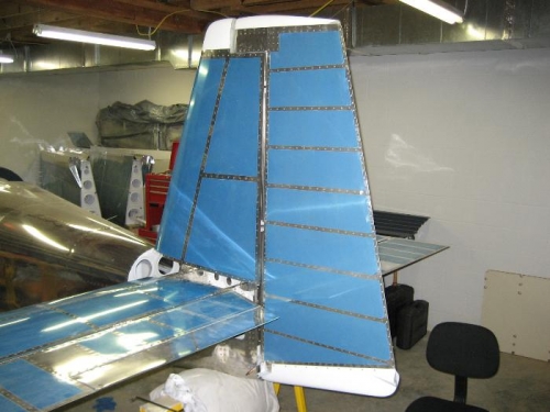

Brief Description:  Mounted Vertical Stabilizer

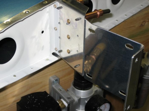

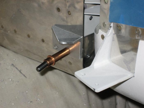

Fabricated elevator up stop and attached to fuselage upper deck. Trimmed VS front spar and mounted to fuselage. Drilled and bolted VS to front attach plate, elevator up stop, and rear bulkhead. Drilled and mounted rear tiedown to rear VS spar and rear bulkhead. Fabricated, drilled, and mounted rudder stops.
VS Front Attach Bracket

Rudder Stop
Rudder Stop
