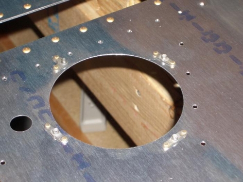

Brief Description:  Installed Side Skins
Deburred and dimpled left and right skins. Drilled and installed nutplates to side skins to hold aileron pushrod boot modification. Installed side skins and riveted reachable areas.Fluted, deburred, dimpled, and countersunk firewall flanges and angle.
Aileron Pushrod Boot Ring Nutplates
