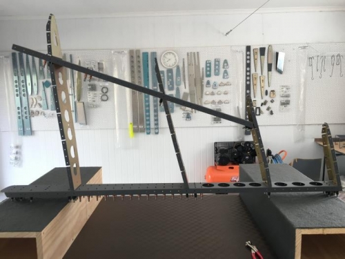

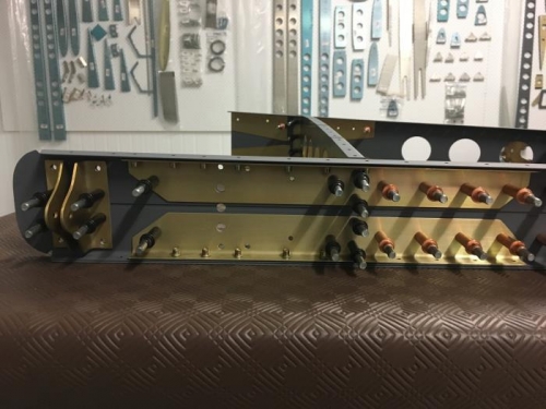

Today I disassembled the vertical stab as the holes on one side of the rear spar didn't line up well enough with spar doublers to get the rivets in. I cleaned these holes out with a 3.2mm reamer, deburred where needed and gave the spar and doublers a quick re-prime.
Vertical stab assembled
