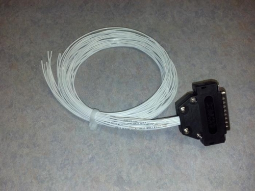

Brief Description:  Pinned Out J2 D-Sub
Pinned out the VP-X Pro J2 D-Sub connector.
This connector is for most of the switches... Flaps, lights, boost pump etc.
I labeled each wire using laser labels and clear heat shrink
I labeled them using the connecter, pin, and description.
Ex. J2-19 Pitch Trim Down
