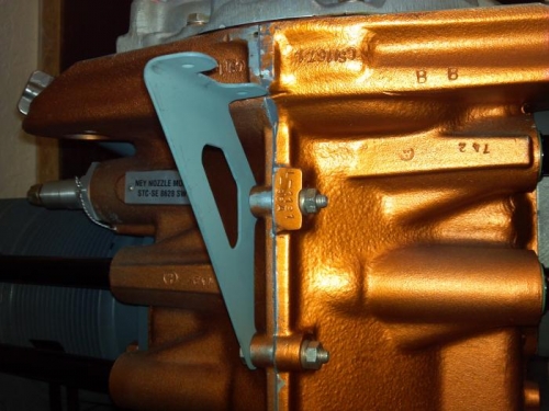

Finished fabricating / deburred the aft support mount bracket.
Installed the bracket via the aft top engine case bolts, replaced lock washers, and torqued to 96 in lbs.
