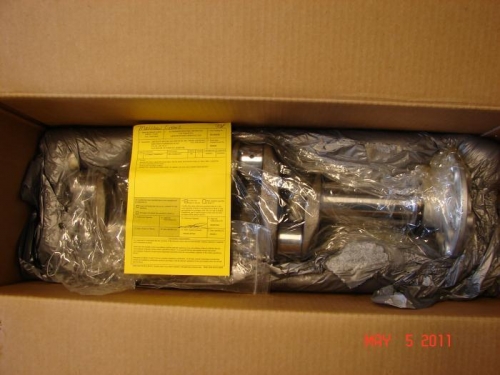

Brief Description:  Crank / Gear Overhauled

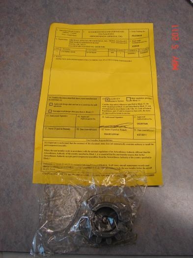

Received the Crankshaft and Gear from Aircraft Specialties, Tulsa OK.
Overhauled and tagged...
I am very happy with the work / turn around time / cost...
3 weeks from door to door, $605...
Straightened the prop flange CAD plated and baked
MagFlux inspected
Mains ground to M006
Rods ground to M003
All the parts are vacuum packed in preservative oil and will be stored as you see them here.
I will be sending out the connecting rods, and accessory drive gears.
Yellow tagged Overhauled
