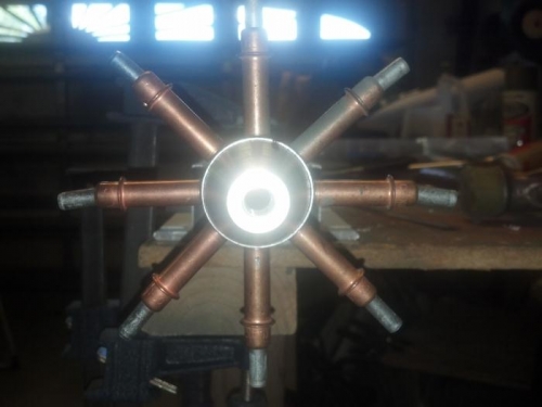

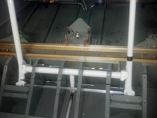

Today I jumped on the elevator push rods and control stick assembly.
Layed out the rivet patterns on the aft and forward push rods, drilled, deburred and primed.
Riveted and installed the clevis and lock nuts and temporarily installed in the fuselage.
I wanted all this in place as I begin to pull wire and antenna cables.
That way I can check clearances and routing as I go. That's the plan anyway.
I also want to installed Van's aileron trim kit, I believe I will leave this a manual trim, try to keep things simple.
Rivet Pattern
Rivet Pattern
Control Stick Assembly
