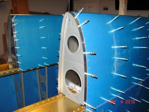

Brief Description:  Installed the W-423 Joint Plate on Right Wing
I bent and installed the W-423 joint plate on the right leading edge.
Did not have too much problem getting it in place.
I carefully checked the rib alignment and joint plate, and match drilled using the skin as a guide.
I continued to check rivet edge spacing with an inspection mirror as I went. All looks well.
I then matched drilled all the ribs on the leading edges of the Left and Right wing.
I believe the next step in the plans is to assemble the fuel tanks.
