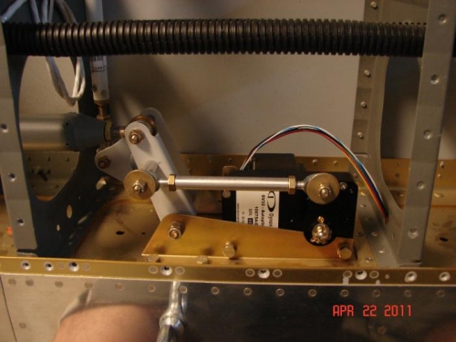

Brief Description:  Right Wing Servo
Recieved the SV32 Servo, Serial # 5105
Rigged right aileron via Van's procedures, jig assembly.
Installed the servo in the right wing.
Torqued mounting bolts to final 20in lbs and applied torgue seal.
I believe I will route the wiring over top the servo body and into the adjoining bay.
Servo SV32
Servo SV32
