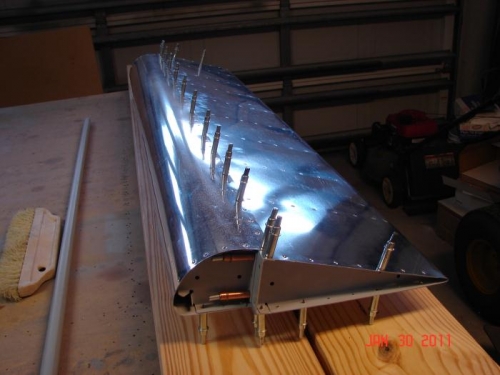

Brief Description:  Riveting / Test Assembly Left Aileron

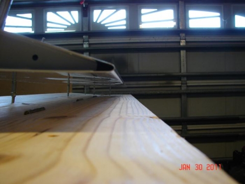

Mounted my brake assembly to the bench and formed the trailing edge.
Turned out nice and straight and ture.

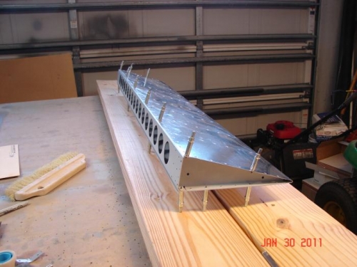

Began test assembly of aileron ribs / spar / leading edge and counter weight.
Final drilling / deburring / dimpling of bottom spar / skin to accomidate the CS4-4 rivets.
Fitted and riveted the count balance weight to leading edge skin.
Prep for the nut plate for the mounting assembly.
Used Brake to form trailing edge
Spar / Rib Assembly
Spar / Rib Assembly
Leading Edge Assembly
