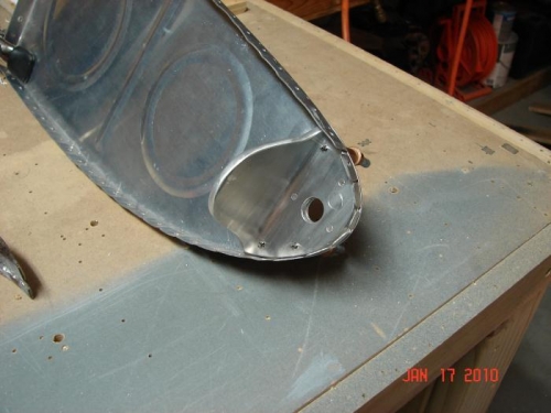

Fabricate the T-405 tank attach angle and pre drill with the rivet holes per DWG 16A.
Clamp the T-405 and T-410 reinforcing plates in place on the end ribs 'and drill the attach holes.
If you plan to use the capacitive fuel gauge senders offered in the you should complete their installation at this point using the instructions supplied in the sender kit.
Drilled the T-405 and T-410.
Drilled the 9/16" hole for the flop tube.
Fitted and Drilled the Capacitive Fuel gauge plates.
Attachment Angle
Attachment Angle
