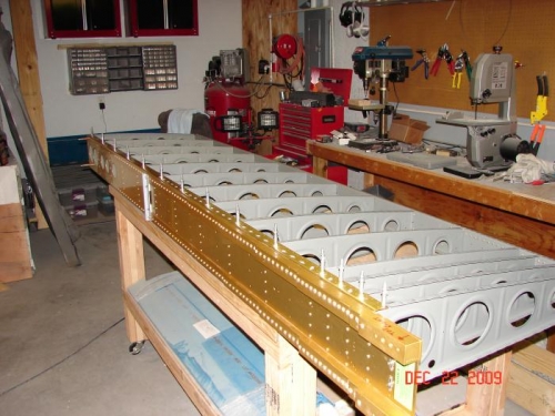

Rivet Right Wing Ribs
Continued the riveting of the right wing ribs to main and rear spar.
Used the same technique as discribed previously.
Double offset -4 rivet set, at 45 psi.
Rivet squeezer with longeron yoke at 90 psi
Inspected all rivets and felt good with the results.
Right Main Spar Rivets
Right Rear Spar Rivets
