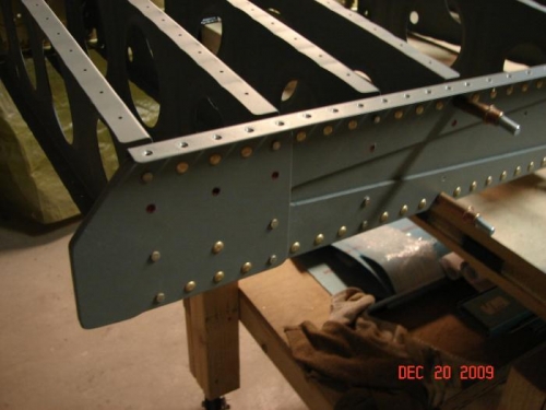

I began with the right wing, since the epoxy primer on left ribs is still setting up.

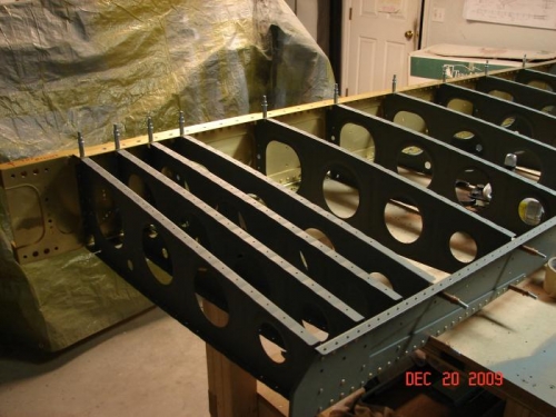

I started by clecoing the main and rear spar to the ribs and making sure everything was supported.
I started the riveting process by removing the inner most ribs 1 and 2.
This way I had full access to rib number 3.
I then proceeded to rivet rib 3 to the main and rear spar, followed by rib 2 and then rib 1.

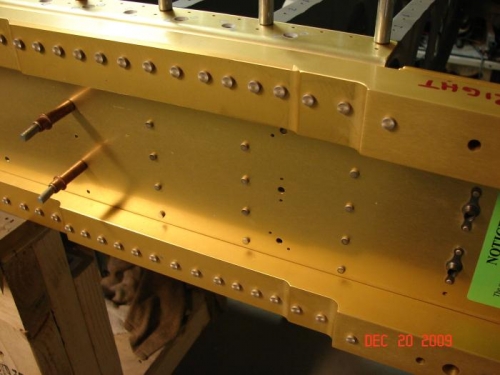

I used my double offset -4 rivet set with my 3x gun, with a setting of 45 psi. I found a 3 second busrt set the rivet nicely.
I used my rivet squeezer with the longeron yoke to set the rivets in the rear spar. Set to 90 psi.
I was only able to get the three inner most ribs installed, before calling it quits.
Rivet Ribs to Main Spar (Right)
Rivet Ribs to Rear Spar (Right)
Right Wing Assembly
Right Wing Assembly
