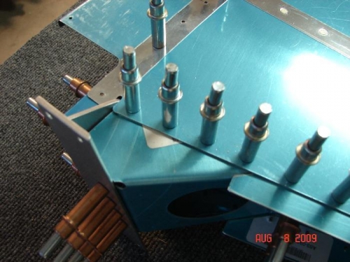

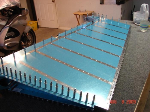

I started this morning... (2:30 am) could not sleep for some reason, by backing riveting the rubber stiffeners to the left and right skin. Turned out really nice.

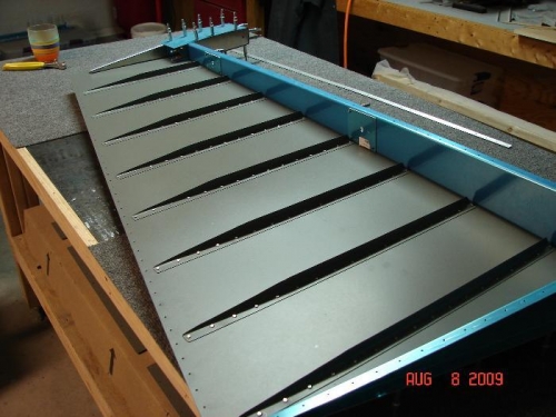

I then installed the skins to the rudder skeleton. Everything lined up well.
I continued to fit the rudder horn R-405PD and rudder brace R-710.
Drilled / Dimpled the aft three holes on the upper skin to #30.
Dtrilled the E614-020 counterweight to R-912 rib.
Dimpled the trailing edge skins.
countersunk the R-916... That was a pain in the butt...
I am happy with the results of today's work.
