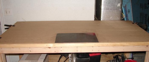

My back rivet plate arrived today.
I decided on incorporating it directly into one of my work tables.
The plate is fitted to the table... and flush with table surface.
The table top is removable...
I did it this way, so as the table top gets abused I can just replace it as I see fit.
In my experience I found it easier to move the work piece to the table and have a secure
platform to back rivet. Some may not agree, but definitely works for me.
1/2 x 12" x 18" A-36 Steel plate.
