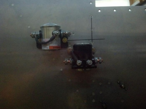

Removed the engine mount, deburred mounting holes and cleaned any powder coat frome the nose gear mount.
Laid out firewall for the master and starter selnoid for the Odessey Battery. Fabricated the F-7127D doubler, deburred, dimpled and coutersunk as required. Revited the doubler / nutplates in place.
Mounted the selnoids, and put the engine mount temporarily in place to check clearances.
