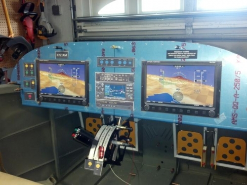

Finished the instrument panel mounting.
Fabricated a temporary mount for postioning the throttle quadrant.
Yes... I was doing some hanger flying.
Printed out to size all the avionics and began the instrument panel layout.
Began laying out the switches... I am use to categorized airline layout.
To the left of the SV1000 Pilot side, switches for Master/Alt 1&2, Mags, Pitot Heat, Avionics Master and starter
Center above radio stack... Ligts in order of brightness, landing/Taxi, strobes, nav, cabin, baggage and dimmer.
Below the throttle quandrant is the boost pump and card heat.
I plan to put an auxilary 12v plug, and heater controls to the right on #2 SV1000.
I may change a thing or two as time goes on, but this is somewhat how I would like things to look.
