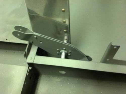

Fitted the shoulder harness anchor left and right.
Drilled, deburred and primed.
Fitted the F-656 L&R plates, drilled, deburred and primed.
Riveted the gusset plates in place.
Riveted the vertical channel to the F-706 bulkhead.
Fabricated the F-635 Bellcrank, drilled the VA-146 flange bearing.
Deburred and primed all the associated parts. Riveted the assembly.
Fabricated the F-635C spacers, and temporarily installed the bellcrank.
Cleco'd the aft top skin in place.
F-635 Bellcrank
F-635 Bellcrank
