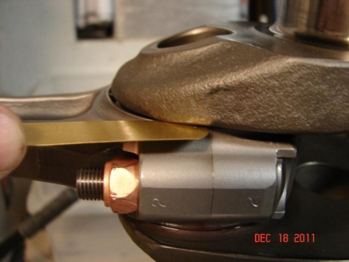

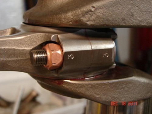

I went to work on the connecting rods... torqued to 480 in. lbs. (40 ft. lbs)
per Lycoming pg 7-14 Sec 7-68/69 - Torque Limits Table 1-37 Ref 900 Type S
Checked side clearances at .008-.010... Table of Limits 1-2 Ref 502, within new limits.

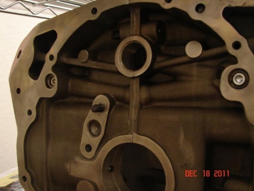

Then I installed the required plugs in the case... Cleaned, inspected oil passages.
Applied sealant to plug threads and torqued to 40 in. lbs. Per Lycoming Torgue Table II Pg. 1-37.
Rods are Torqued
Rods are Torqued
Side Clearance is Fine
Plugs are Installed
Plugs are Installed
