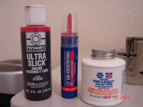

Installed "NEW" Oil Filter Adapter, gasket, sealed and torqued.
Installed "NEW" one piece Oil Pump Housing, impeller gears and Shaft. (P/N 05K19423-S)
Pre-lubed, Torgued to 150 in lbs, and safety wired in accordance with the following.

Assembly Products
Assembly Products
