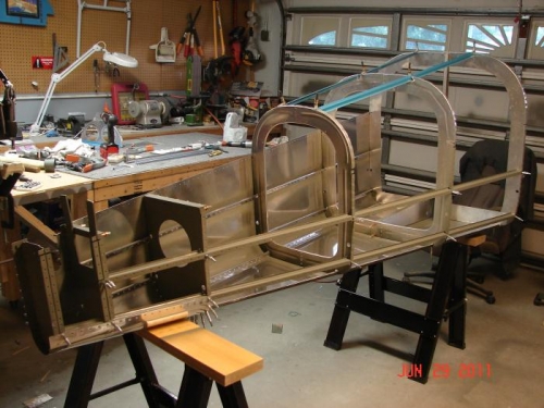

Started by assembling the bottom skin, and the F-707/708 bulkheads.
Riveted the bulkheads to the bottom skin.
Installed the J-channels, and the tail skin and F-710/711/712 bulkheads.
Installed the left skin to help hold everything together. cleoc'd only for now.
I need to do more deburring and dimpling the right skin.
Aft Fuselage
Aft Fuselage
