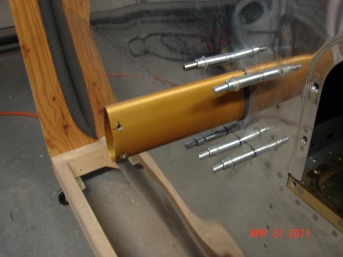

Continued to finalize the left wing.
I torqued the bellcrank connecting bolts, and applied torque seal.
The aileron is rigged, can't see getting it any closer. half turn here and there during funal assembly.
Riveted the platenuts for the inspection cover.
Mounted the Pitot mast by mixing up some tank sealant and applying it to the mast's internal mounting plate and then cleco'd in place for now.
I riveted the aileron max travel backet in place.

Pitot Mast
Pitot Mast
