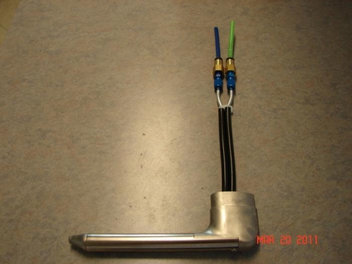

Brief Description:  Push Rod Tubes
Continue the main push rods...
washed out the inside of the rod with acetone.
Mixed up 3 part epoxy primer / Sealer.
Poured it into the the rods and spun the rods as I poured it out.
Repeated this process twice on each rod... Seemed to work really well.
completed riveting the rod ends... Cleaned the outside of the rods with acetone.
Scuffed the outer rods with soap and scotch Brite... Will be epoxy priming tomorrow.
I also cut and flared the ends of the Pitot/AOA system.
Pitot/AOA
Pitot/AOA
