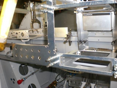

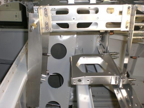

So I did all the cutting, fitting, clamping, and drilling for the rear supports. I also had to make brackets for the rear tray brackets for attaching the supports to the rear brackets.
The brackets came out good and I began to see what other boxes I could attach to the support brackets to maximize space behind the RV-8 panel that is very limited. It looks like the GTN support brackets will work great for the Engine Module and GAD 29 module.

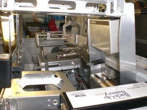

I believe the best location for the EFIS backup battery will be on the right side of the panel area. I want to mount it with the base facing down as it is pretty heavy and I don't really want it to hang off a side structure.
On the far left side of the area is where it looks as though the Remote Radio and the Remote Transponder will fit. The remote radio is just a metal box that bolts in and has an antenna and
D-sub that connect to it. On the contrary, the remote transponder has a tray and must be in a place that allows it to slide out in order to remove it. So I am placing the remote radio below on the left side and the transponder on the top position on the left side.
So I at least have a general idea....but will ponder if there are any other configurations that will work better before committing to the current locations.
Left side looking in
Right side looking in
View through G3X holes
