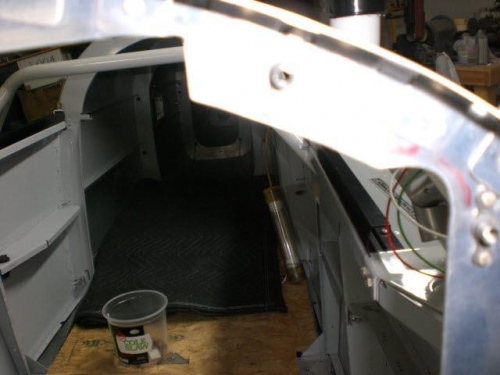

I decided the prototype proved the layout of the boxes. As I mentioned I made some small corrections to openings and locations....you would never know without a good machinist scale to tell.
Tonight involved removing all the boxes from the panel and putting them back in their boxes in order to remove the prototype panel. After removing the proto panel I began to mark the locations of where everything goes on the "real"panel. It is very important to mark up the panel so when cutting the various openings I can be certain I am cutting in the right location.
Next I had to clear out an area in the instrument panel frame for the top left corner of the chrono clock seen in pic 3 in the right center of the pic.
Avionics and proto panel removed
Locations marked on
Locations marked on "real" panel
Clearance cut in frame
