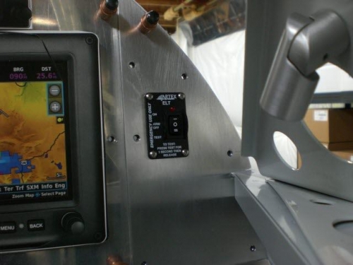

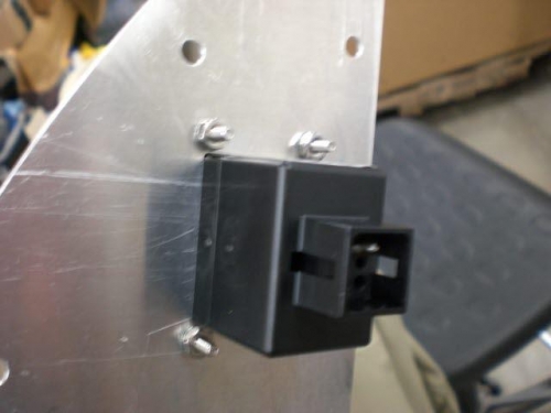

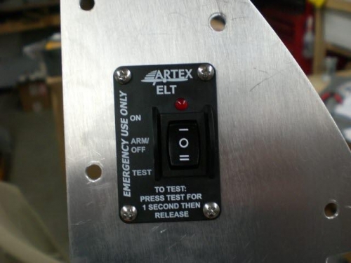

I decided to cut the opening for the ELT remote. I drew up a sketch for the opening and the hole locations. The face of the remote is not centered on the back portion of the switch. It is actually offset by about .045 inches. So I got the measurements and drilled the holes off center to match.
With the sketch in hand I went out to the mill machine and wrote a short program and cut the opening for the body and drilled the holes in location.....fit perfect.
I attached with the screws provided. I am trying to get everything located and cut so I can prime and paint everything and do some FINAL assembly!
