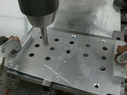

I was happy with the CB panel and the extra breaker inserted to the bottom row. I decided it was time to drill the "real" panel. I set the panel up in my mill machine and wrote up a quick program for the CB locations. I ran the program through the hole locations 3 times. First the center drill to confirm the locations were correct....second a 3/8 inch endmill....finally a boring head that took the last cut to being the holes to the right size.

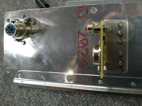

I attached the small circuit board to the side panel where the light is mounted. I riveted the board to an aluminum plate and then put some nutplates in the plate to attach it to the panel. That was better than trying to modify the circuit board attachment feet to fit screws....potentially damaging the board.

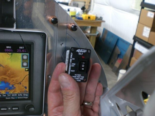

I played around with where to place my ELT remote...I think a good place would be on the right subpanel.
Real CB panel holes cut
Attach circuit board
Pondering ELT remote location
