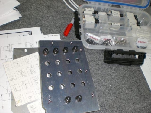

Tonight I completed the prototype CB panel marking and drilling with the hole locations from the poster board layout. I used a step drill but if the locations work out good I will do the "real" panel on the milling machine.
After marking and punching the locations I used a #40 drill to put a pilot hole in the panel. Then I used the stepdrill to open the holes to 7/16 inch. I deburred and then inserted some CB's as I am going to fill the panel and put it in the airplane to see how it fits and for any issues.

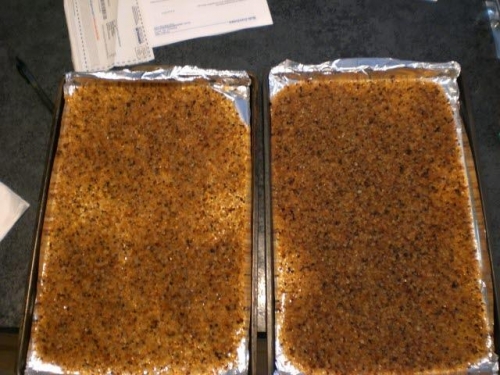

My friend Jim reminded me to check my desiccant in my engine box. I opened it and looked in and the bags of desiccant beads were pretty much white. I put them on cookie sheets and baked them at around 300 degrees for what had to be a couple hours. I started at about 200 degrees but it didn't seem to be working well....so I "turned up the heat" and the beads started to comply. This seems to be the darkest they are willing to get....so I will place them back in the bags. I also ordered another 5 lbs more of blue to pink desiccant to add to the supply....a small price to pay for an expensive engine!!!
Holes marked and drilled

Dried Desiccant for Engine
