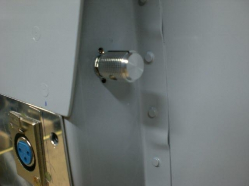

I cut the shaft on the GIB light rheostat about 3/8 of an inch to get the knob to be where it is needed. They give you a longer shaft for customizing the installation for depending on where you are installing the knob.

Cut shaft on GIB rheostat
