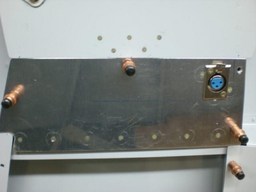

Today I was able to finish the panel. I got the holes drilled, countersunk, and nutplates riveted. I got the center bracket riveted in for the screw in the top edge center.
I did not put the panel all the way down to the bottom brace because I am thinking of making a fabric pouch there for the section below and need the brace to potentially put a fabric cover with velcro or something to have a flap......not sure at this point but needed the brace. The bottom flexed more than I liked. I have some stiffiners that I didn't use from rebuilding my crunched elevator. I used one of the stiffiners and cut it down to length and cut the perpendicular angle to have only about 1/4 inch left. I drilled and riveted it to the bottom and now it is nice and solid.

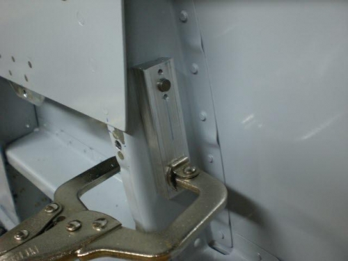

Next I made a hole for the rheostat on the right bulkhead easily reachable but out of the way. The rheostat has a 1/4 inch hole with two #38 holes cut on a 1/2 inch circle around the switch to accept two lugs to keep it from turning. I made a jig to get the holes where they needed to be.

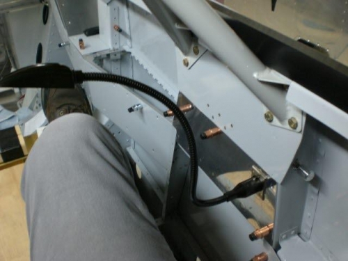

I also cut the hole for the removable gooseneck in the side panel and tried it on.....it will work great for the GIB. I will take it out and store it and it will only be inserted when needed by GIB.
Panel fit socket installed
Jig for rheostat
Jig for rheostat
Light for GIB
Light for GIB
