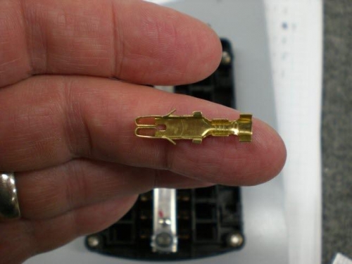

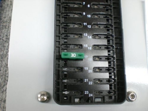

As I am preparing to run wiring I wanted to get familiar with the Bussman Fuse Block I purchased. This block is different in that the terminals snap in behind for the wire side of the fuse. That works great for how I designed the cover by the pilots right leg under the right console. I can have all the fuses available in front with the wires in the box. My airport friend Ralph suggested I look into the Bussman....I am very glad I purchased a 24 slot block. The block can also be split into three different busses with 12/8/4 circuit busses if you want.
Anyway I experimented with inserting the pins and using a couple extractor tools from amazon I was able to successfully remove the pin a couple times. I am going to like this little holder. I will be using a mix of fuses and circuit breakers.

Fuse Block
Fuse Block
Fuse Pins
Fuse Pins
